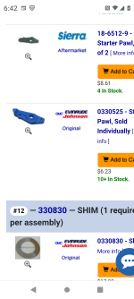

Early to mid 90s evinrude 25 hp 2 cylinder. Need the blue plastic pawl on the underside of the recoil starter. Anyone know if thar part is available separately? Part number? This is the plastic piece that flips out to engage the flywheel. Thanks

0330525 available all day long.----Are there 2 on your motor ?

There is a spot for a second one but the clip and wire are not there. Did some use only one??
39,459
Early motors used only 1 pawl.----A tough job for one pawl.-----So they went to 2 pawls.----Recoil was also mounted with rubber mounts so thar housing could flex and share load on the 2 pawls.-----I recommend you use 2 pawls, but it is up to you to act.

Yeah looks like I need 3 wires and 2 new pawls and e clip for the missing pawl
