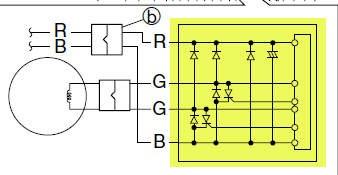

I am looking for something that depicts the regulation of the voltage.
This is a Yamaha diagram. Looking for something equivalent from Mercury.

The rectifier is a full wave one - 4 diodes; the regulator is a secret! This is how I added a regulator to my 850 works great holds V to 13.5.
