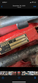

The Parker I have is a 2520 built in 1997. It has a Volvo Penta 5.7 Gi-F . The receipts going back to 2015 and the hour meter state 650 hours and it seems accurate. The engine is painted red and has a vortex intake manifold and ( I think ) a HVS ignition because of the "crab" shaped flat distributer cap. I thought the engine would have been installed from the factory but several things indicate something different. One site states that "Engines produced after 2000 were once again painted red" and "Between 1993 and 1998 Volvo produced their engines in partnership with OMC. These engines were painted in dark charcoal."
I have not been able to decode the serial number 4012191678 or prod. number 3889311
Maybe someone dropped in a whole new engine in the 2000's then didn't run it much?
I've used this link but still cant figure out the year.
Any way too figure out the year on this motor?

Have a picture of the engine? Where is the raw water pump mounted?
What makes you think its a Gi-F?

Here is my theory on it.
Originally it was a black 1997 VP GL carb or GLi tbi engine.
Something happened to that, then someone has made it a hybrid, perhaps using the black block from the GL(I) and top end and running gear and ecu etc from a red Gi Mpi. Likely about 280hp if it’s GLi spec.

I think you’re right based on this photo. It looks like there is black paint that was hidden and then red paint over it. I’m assuming the original red blocks would’ve been painted in the section and not show black.

It might have one down near the starter motor. But you might have a 97 block with a 2000’s and something ignition and injection system

That is definitely not the original engine. Original engine had a different raw water pump and V-belts vs your serpentine belt. Original raw water pump was belt driven.
Your original engine was a charcoal grey...not black. It's dark but it is not black. Anyone who has actually owned a Volvo of that vintage knows this. Mine is also charcoal grey.
