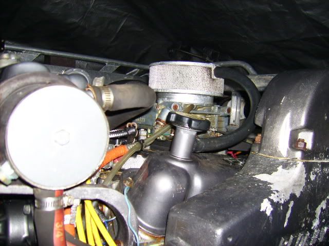

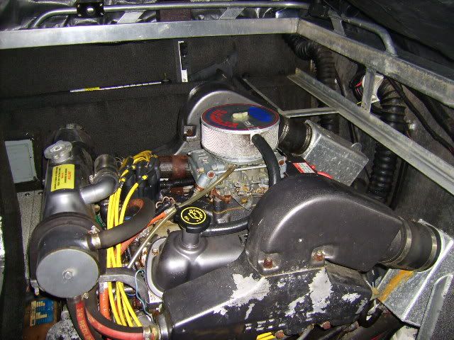

Here's a few photos of the motor:

I can see some #s stamped on it by the orange hose in the 3rd picture down....
Probably a Tag riveted to the other side with the Name of the manufacturer....
Looks like she's seen some Saltwater,... Pretty Rusty.....
Plain ole Holley carb,...
Little electrical box behind it probably mimics the Merc. set up,...
Might have an extra solenoid if it uses a Ford style starter....
I don't see anything I couldn't get at my local Napa, either off the shelf, or overnight....

looks like a prestolite with screw down cap and holley 600cfm

DO NOT get chrome anything if you even think about going near salt water. They rust faster than anything else. You need to get the proper coil for your type distributor, you do have a Prestolite with a screw down cap, but it's hard to tell if it's a points type or the Prestolite BID electronic distributor. Different coils ya know.
I wouldn't get SS bolts for the manifolds either, from the looks of things, they are aluminum which will not last long in salt water, and will take out the engine if you aren't careful. SS bolts through Aluminum is a recipt for frozen bolts.
Clean the rust, pull the bolts, clean them up put some permatex aviation gasket sealer on them and reinstall. They will be fine
