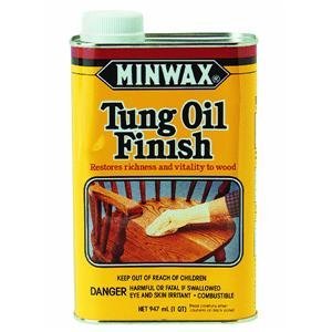

Tung oil is a very bad idea!!! Tung oil is a interior only finish! It will peel in no time.

That's funny...These guys been making it for Marine use since 1910. I been using it for Exterior Teak Furniture for 25 yrs and it doesn't peel and has UV protection.
http://www.amazon.com/Waterlox-Original-Marine-Tung-Finish/dp/B001P99C4U
That is much different product and five times more expensive than what the typical home depot would have on the shelf!!
$8.00/Qt to your 40.00!
