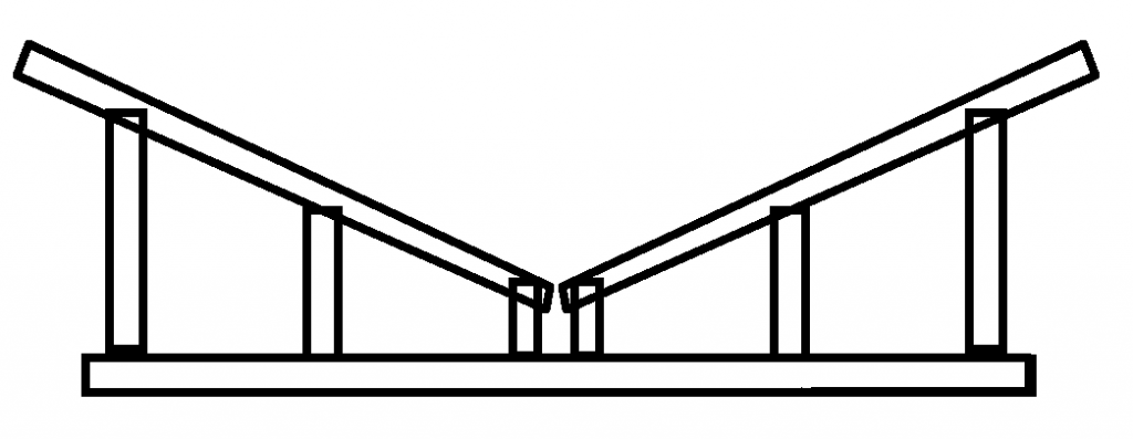

Are you planning to do this bunk work soon? It's still winter & cold as carp in Illinois, correct?
Make a short stern cradle, w/ a slight V notch to set the stern of the boat down on. Simple, not very tall, just tall enough to have the hull high enough to clear the trailer. Carpet or padding on the 2X's the hull will rest on. 2 16ft 2X4 should be enough to build 2 small cradles. 1 4ft piece for the bottom, a couple of 30"+/- pieces for the angled parts & the rest to make the vertical 'legs'
You can drop the trailer tongue to the ground, off the hitch, that'll raise the stern a few inches (maybe more). Use that height for the small cradle. If you think it'll be a longer term trailer rehab, you could make the cradle 75% the width of the stern, 6-7ft long. Since you'll be fitting it TOO the hull's shape, as long as there are legs every 12" or so, it should be fine. You can add horizontal leg braces like you did the feet of your original gantry to help keep the cradle from rocking, if it'll be sitting there for a while. Esp w/ a snow load. Might even use a 2X6 instead of a 2X4 for the whole thing.
Cut a similar sized top (angles) & bottom pieces for under the bow. But wait until you started to pull the trailer out to finalize the leg lengths & put it all together. W/ the rear cradle in place and someone helping push the boat off the trailer (they are really holding the boat back & pulling the trailer forward) you should be able to ease the boat back until the curve of the bow is just about to come off the trailer. You want your forward cradle to be back fair enough to let the trailer push back to the boat & be easy to winch back up on the trailer.
Does that ^^^ make sense?
