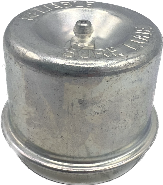

Going on a trip soon have a question. My boar trailer has reliable sure lube brand hubs (the kind where only a zerk fitting sticks out). I pumped 20 pumps of grease in but don't see it coming out if the inner seal or spindle or hub. Not sure if I did that right. Bearings were packed 2 years ago but I've only dunked it 2 times since then. Wheel turns smoothly with no noise or play. What am I doing wrong? Thank you

From what I see with some research, this Reliable Sure-Lube is a grease cap. It's not the same thing as the Reliable/Dexter Axle lube, which has a grease fitting on the end of the axle. With the Reliable or Dexter you push grease in the fitting, It goes through the axle to the rear bearing, through the front bearing and when the axle is full the old grease pushes out the front, around the edges of the axle where the filler fitting is. The Reliable that does this has a rubber cap over the grease fitting, which is built into the axle and is not a metal dust cap.
I have a 95 Ranger Trail trailer with this type of setup, but mine isn't a grease fitting. The grease gun needs a needle type attachment instead of the regular grease gun fitting. It's a really good system.
What I see at the Trailer Parts Depot site is just a dust cap with a grease fitting; not the same thing. It's like a Bearing Buddy without the springs etc. So it seems like you'd be pushing the new grease in the front bearing, through the middle and finally to the rear bearing. There is no exit for the old grease.
If this is new to you, I agree with taking it apart to check the amount of grease and condition of the bearings and seal. The alternative is to keep pumping until the grease comes out somewhere, probably around the seal.

That's true, if the OP had the Sure Lube axle, but in his post he said he doesn't have the rubber dust cap cover with the grease fitting underneath. He said he has just the metal dust cap, no rubber cover, exposed grease fitting. I included a picture of that type in my post. The metal dust cap doesn't provide any special flow of grease other than lube through the dust cap fitting to the outer bearing. If the metal dust cap is tight enough, he could push the grease to the inner bearing.

The rubber dust cap with zerk on end of the axle is the EZ-lube system with different internal grease routing. The OP has the Sure Lube axle that utilizes the metal dust cap with exposed zerk, like you pictured.
These don't have the rubber plug. They are a solid metal cap with a grease nipple in the center.

I totally agree with you. I thought that's what I was saying. It's certainly what I meant. Maybe the confusion is because I said that when you have this metal cap and put grease into the fitting, the only route is through the outer bearing to the inner bearing. There's no exit for the grease except past the seal.
I see it as a better version of the Bearing Buddy since you're using real pressure to put in the grease. Bearing Buddies have that little coil spring which doesn't have enough strength to push the grease at all.
