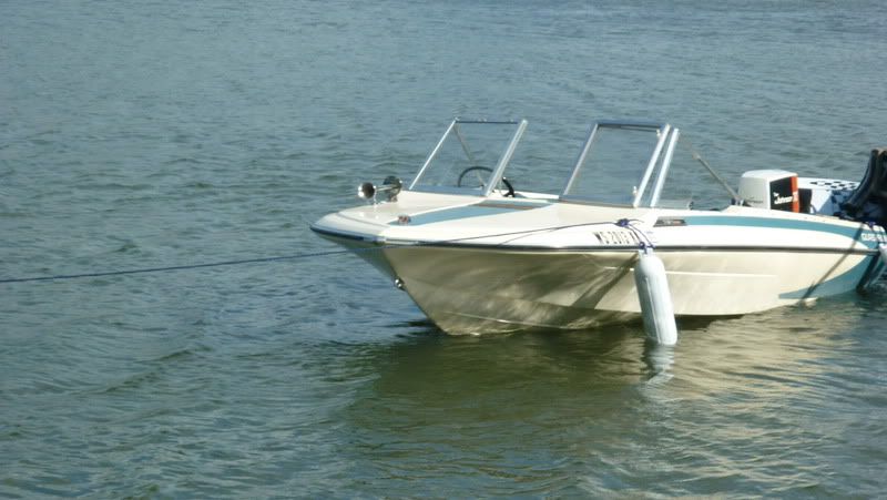

How do you like the ride of the tri-hull? I was looking for one because I like the open bow but I could not pass up the deal I found on my glastron.
Very steady at anchor and at slow speeds, but when you are blasting across the lake WOT, it will shake the fillings out of your teeth. It does seem to cut a very tight corner at speed, though. I can very easily turn kids from tube riders to swimmers by throttling up and cutting the helm over :)
I would probably look for a v-hull bowrider for my next boat (whenever that may be)

I had a few old runabouts in the past before I got my glastron. I had an old Stuery that always seemed to plow through the water when there was a wake...and my old Larson rode real nice but never seemed quick enough. When I got my glastron on plane the other day I was amazed at the difference in ride quality. It was pretty fast and handled the very rough chop on Kentucky Lake in 15mph winds very well. It really smoothed them out. I always liked the idea that the tri-hulls were stable at rest and very roomy though. I am anxious to tear down the carbs...Thanks for your help and I will keep you posted. This was my $200 boat when I first picked it up from an old man. I also gave him an old outboard. Glad I took the chance on it! The only thing I needed to do was replace the steering cable...of course the upcoming carburator work. As I see it when you buy a boat for under $2000 there is going to be some work needed anyway. If you can find one (like you did) for cheap and put a few hundred into it by doing the work yourself it is worth it and rewarding.
