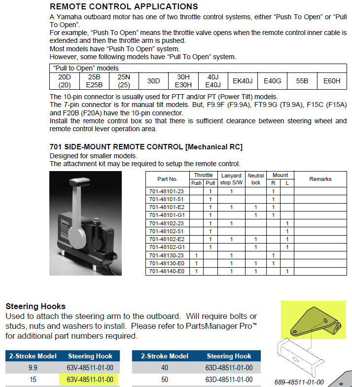

Could find the whole kit but it must be out there. Here is the bracket that bolts to the transom.

Here is a better picture of the concept.
