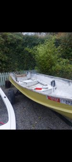

I have an old 12ft alluminium boat with a fiberglass top cap (I think it's called a top cap) I was just wondering if anyone knows how to remove it and if I would be able to remove it without destroying it as such so that if I wanted I could put it back on. Pictures belowScreenshot_20221016-210738_Gallery.jpg

Do you recommend removing it for this boat or would it be better to keep it on, thanks for the reply appreciate it
53,291
if you have to get under it to restore the foam and transom, yes.
however that cap is adding structure to your hull. if you plan on removing it for the sake of more room, you have to add some structure back to the hull.

And what would be the best way to add structure with the top cap gone?
53,291
depends on what you want.
however based on your posts, you want a simple utility boat. in that case, would be cheaper and faster to sell what you have and buy what you want.
some aluminum utility boat gunwale stucture is a T-bar gunwale, some is a formed channel.

Being an aluminum boat it should be stiffer than a fiberglass boat. Still make a couple of plywood cradles to set the boat on, they should extend up to the rubrail area. And measure everything and document it all before removal, during repairs and before assembly.
53,291
I think the OP is trying to turn the runabout into an open utility/fishing boat
which would be remove existing cap, create new gunwale and seat structure.
Grub54891
Jun 17, 2012
6,491
Ah yes. That would be more work than he needs to do for that. Unless the rail is actually under the glass top. Sure would make it lighter!
