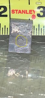

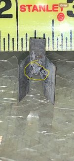

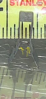

I'm trying to remove the upper/outer trim from the plexiglass windshield of the 1963 Starcraft Starmist. I managed to get only ONE of the 6-8 or so clips to release. It's brutal! I tried to make a tool to get it done, but gave up after an hour or so.
Is there a trick to do this? A special tool perhaps? Please help….
Here are pics of the devious little critter:
I circled the little half moon tabs that pop into the hole in the plexiglass.
