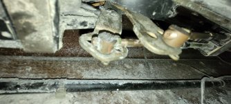

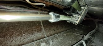

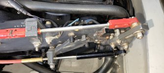

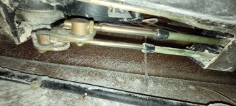

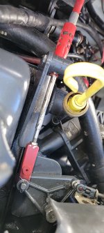

Hi Todd,
The first pic is the throttle OMC 2.3.
I did my best trying beind the side panel. There is an attachment point where both cables are side by side but can't get a clear picture of it so I don't know what may or may not be part of the cable itself.
Any help is greatly appreciated.

Shift and throttle cables are specific to engine type. What do you have? MerCruiser?
matt167
Sep 27, 2012
4,459
You can use run of the mill Type 33C/3300 cables with an adapter. Seastar solutions CA27320P for your OMC 2.3L
