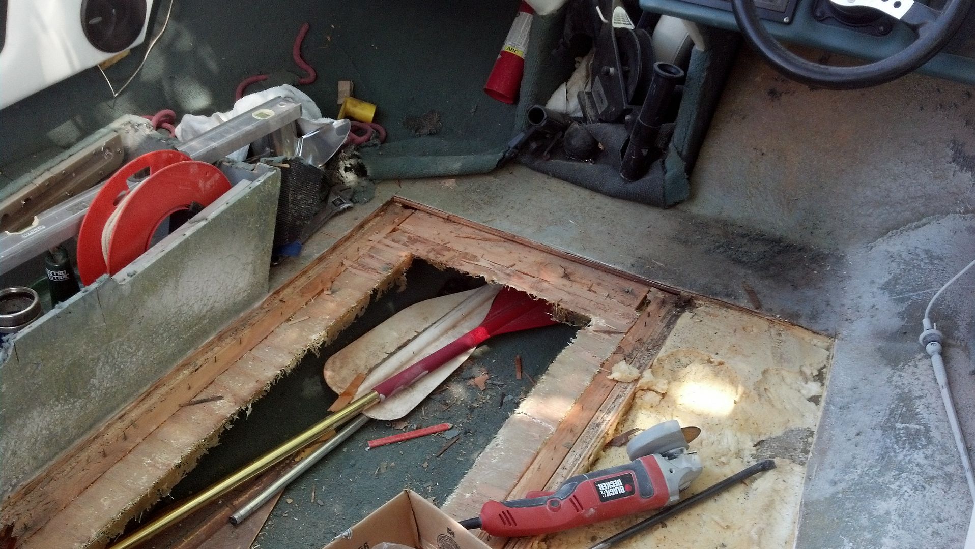

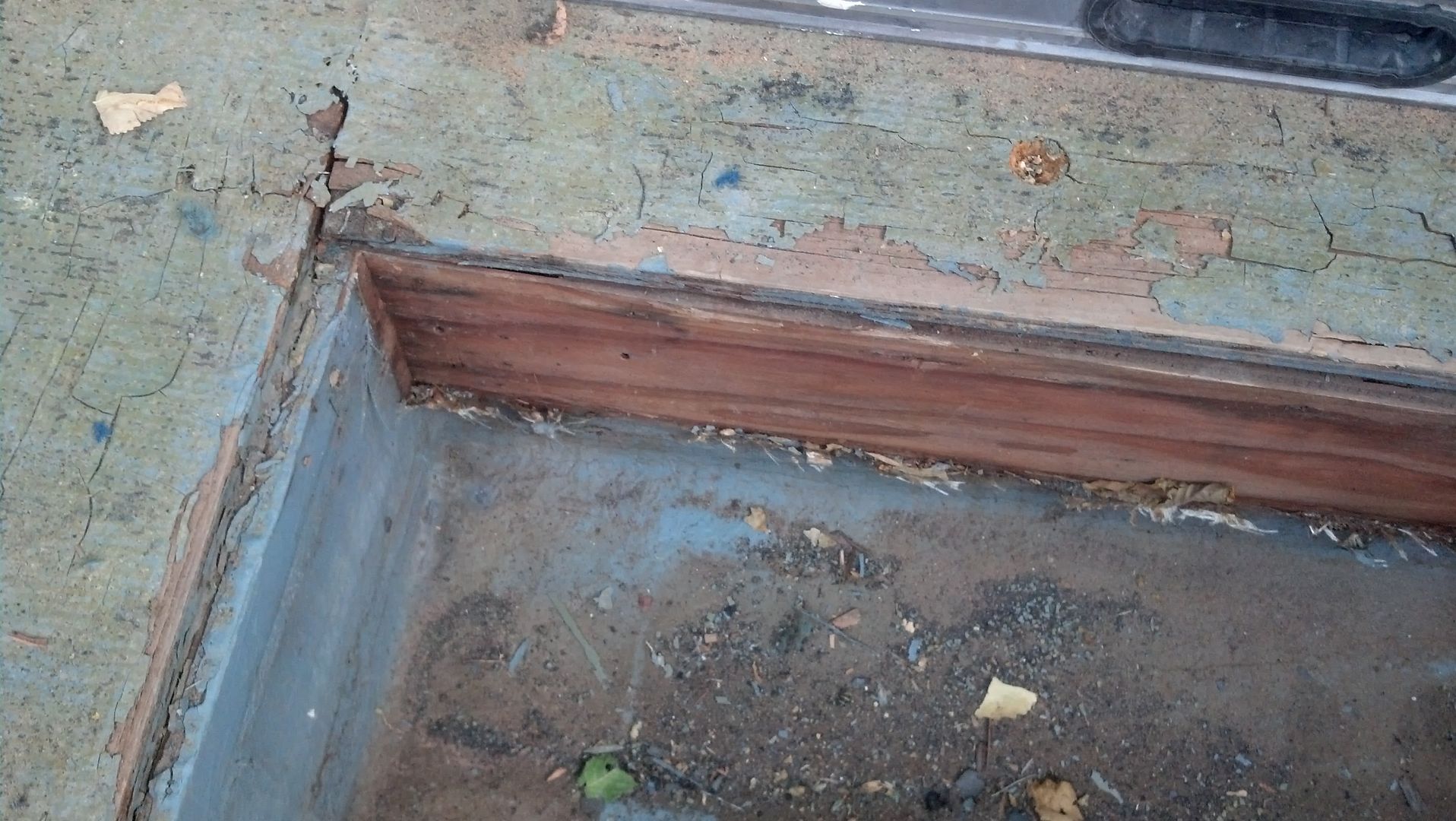

Yeah, pics straight from my laptop work just fine. I will post a few more pics so you can see some of the issues we are dealing with. Looking at the pictures, I am guessing we should go ahead and remove the seat box we want to rebuild to get rid of the split plywood supporting it. Not sure on the cooler box, guess it will be walked on getting around the boat so should be solid as well. I see how you get sucked into dumping way more money than an old boat is worth. I want/have to keep this fix bomber, but affordable.

I don't see too much rot (if any) there. Perhaps others can see things I am missing.
