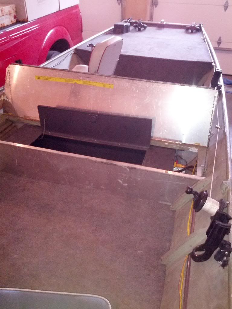

Correction, it is not pressure treated ply in the boat. I got the boat used and just assumed it would be treated. I was not aware that green plywood would eat aluminum. It's either 1/2 or 5/8 depending if it's swelled up any. And I'm trimming up more than just the floor to save weight. My goal is to save around 100 pounds total when I'm done with everything. For instance i have 3 anchors on the boat now and one of those is coming off. I'm hoping the floor will be 30ish pounds shaved off if I can find the right materials without it being too flimsy. Im not sure of the name of this firewall stuff, I've only seen it on jobsites. But it is different from that coroplast stuff. I'm thinking if I put r-board insulation in between the ribs and put this board over top it should be strong enough and not flex much. For those concerned my boat setup is:
1976 Lowe Line 18' flat bottom (rated for 35hp)
1978 Johnson 35hp seahorse shortshaft with 11pitch prop
I blew a cylinder last fall so I got ahold of a used power head in great condition and just finished putting it all back together about a week ago. Both cylinders are at 125psi and I've only tank tested it but it seems to be running like a top.
I'll work on getting a couple pics.

We see lots of boats here with wet/rotten plywood and foam, but all of them are usually left uncovered outside and exposed to the elements.
It looks like you keep your boat garaged though, so your plywood probably isn't that wet if at all. The decking will dry out if it's only exposed to occasional weather and kept dry most of the time like I think yours is.
If your decking was installed correctly with the carpet glued to the plywood and then screwed down to the boat you should be able to remove your bottom decking easily by looking for the screws buried in the carpet nap, just back the screws out and lift the decking up and check the back side to see if it's wet. If it's dry, just lay it back down in the boat and put the screws back in. Not a big deal, especially with that nice simple setup you have.
... but! If the decking was screwed down in the boat and then the carpet was installed you'll have to rip up all of your carpet to get to the screws to remove the decking... after you sand all of the old carpet glue off so you can find the screws.
