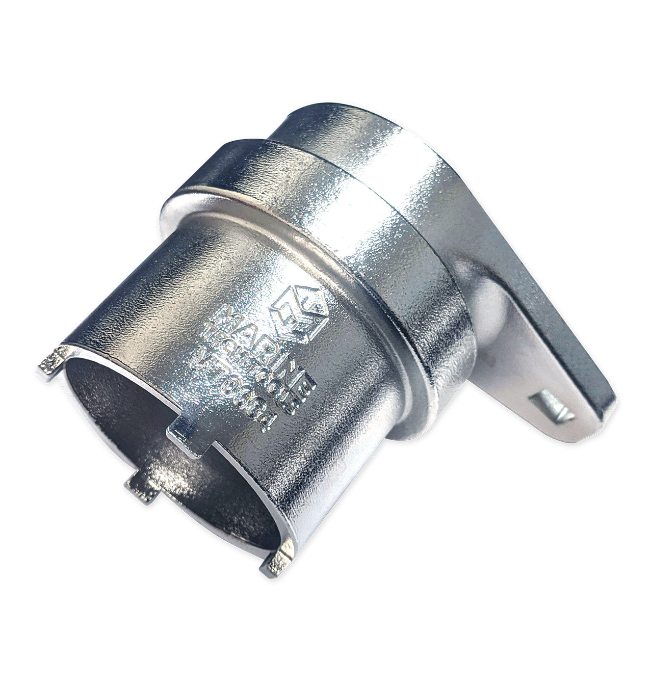

thanksfor the reply guys, do i need both those tools? the book really does not spell it out too well.
im unclear as to where the 2 different tools come into play.
91-805374 &
91-8053741​
and the 805382 retainer tool.
it looks to me like i only need the 5374
but i have never done this before.
from the merc manual:
7. Remove outer propeller shaft bearing retainer, by turning clockwise, using outer propeller shaft bearing retainer tool.
a - Bearing Retainer Tool (P/N 91-805382)
b - Bearing Carrier Tool (P/N 91-805374)
c - Bearing Retainer
8. Remove inner and outer propeller shaft assembly from gear housing

In order to properly remove/install the seals the propshafts need to be on a bench. I use a small slide hammer to remove the seals. Too risky with damaging the carrier housing cavity with a seal puller
You will need the special tools to do this job correctly

am i correct in thinking i need all 3 tools ?
Bearing Carrier Tool (91-805374--1)
or is there a new version of the retainer tool that does both jobs?
other than pullers is ther anything else i need to do this job?
alldodge
Mar 8, 2009
44,649
so alldodge, I looked at your post, WOW, you dug deep.
I don't know of a newer version for the tools
Need the 2 piece bearing retainer tool for the inner shaft and the other for the outer carrier
You need to remove both shafts. When removing keep track of the shims and make sure they go back in the same way and number

Should work if made the same and distance from center to 1/2 drive opening
It probably is but the distance matters when using torque wrench calculations
Most likely it is correct
