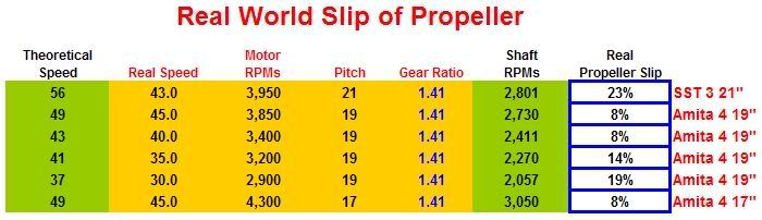

I am sorry to hear about your outdrive, I remember you mentioning that you were worried about stressing them, and it appears you were right. Since you were able to confirm the gear ratio I was able to do some real analysis on Prop slip for the old SS and the new 4 blade props. The analysis shows that by changing to the 4 blade amitas we were able to decrease your prop slip from 23% with the SS to 8% with the new amitas at WOT.
The thing that still amazes me is that we had no gain in RPM and in fact have even lost 100 RPM, even though we had a theoretical change in prop pitch of 3", that is why I had mentioned earlier about this only being a science to a point and then it becomes an art when you change from one blade geometry to another. If you could take some pictures of the new props from the sides and directly above them I would certainly appreciate it, as I would like to see the exact blade geometry of these props for future use, as I recommend them to people as an inexpensive 4 blade alternative. And do you see any cup on the trailing edge of the props and are the blades flat from the leading edge to the trailing edge or are they pretty concave.
Prop Slip
We now have a baseline for the amita props on your boat because we have real numbers for 19" pitch props. With this baseline if we change to 17" amitas we should have an increase of RPM to about 4,300 and I do not believe we will lose any speed because of the increase in RPM from the new props and it may be better because we are closer to the maximum operating RPM and horsepower. I also believe there is a very good chance that you will be able to plane on one engine with these props, and if you can't I may have a way to help them get the boat up to planing speed. By changing to the 17" props we will also have less stress on the engines, the low speed planing MPH should be lower as well and the fuel consumption at the midrange speeds will also go down. Since there is less stress on the motors from being overloaded they are able to use less fuel at any RPM setting. If my numbers are right you should have better speeds at the RPM you quoted in your last posting. I am sorry I didn't get it just perfect the first time, but when you change blade geometry dramatically it is an ART, not a science.
