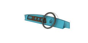

Stock dash vs custom.
I removed the old cable steering system and replaced it with a SeaStar NFB system. For nostalgia sake, I retained the original steering wheel and center hub.
The dash will be painted white, the inserts will be Teal to match the seats and boat paint.
