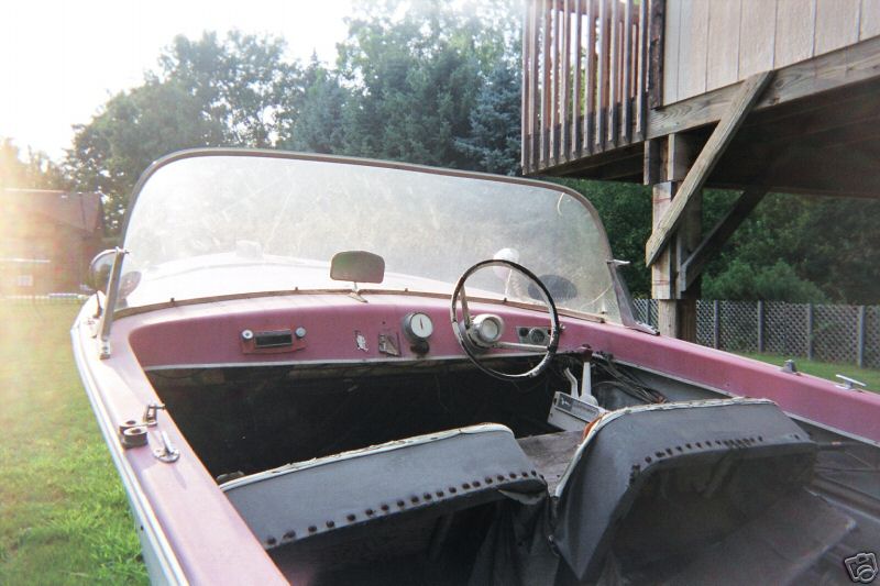

I am acquiring a boat for my next restoration project. In blatant disregard of the wonderful advice of this forum, I am buying it sight-unseen. However, I'm paying next to nothing for it (the gas to go pick it up will likely cost more.) I figure if I'm out $25 when I get there, I'll survive :) Worst case: cheap trailer.<br /><br />Anyway... I'm trying to identify the boat (the seller knows absolutely nothing about it.) All that they said is this: <br />-year may be 1966 or 1970<br />-14' or 15' or maybe 16'<br />-single I/O <br /><br />When I pick the boat up, I'm sure I'll have more info, but I'm just trying to dig in and get some research done now (i.e. where to find parts.)<br /><br />Any help is appreciated. Once I get the boat, I can post better pictures and more info.<br /><br />Thanks!<br /><br />

yeah, could be an MFG I guess. Having a hard time placing it on http://www.mfgboats.com/index.htm <br />Seems like most of the boats in the late 60s were white hulls with colored tops. Guess my boat coulda been repainted.

take that back, I though the top was white, looks like it was originally red, and just faded to light pink. Hrmmm. <br /><br />Mark42 - looks like yours started off a little better than mine... but you said in your project that the stringers were solid fiberglass? Assuming this boat is an MFG, do you think that means I have a chance in heck of not having to replace mine? After reading this forum for a while, I've kinda resigned myself to tearing out and replacing the floor/stringers/transom/etc.

Hi gextyr1,<br /><br />Just saw this thread. Nice boat! I think it looks like an MFG too. Probably from the early 60's because the 50's had the wood deck. I think that boat has no floor or simple floor over the ribs. You should be able to see the ribs on the floor and some metal bracing if I remember right. The navagation light in front looks correct, but there are those neat "wings" on the trailing edge of the windshield that don't show on any MFG. My guess is that they could be a side view mirror accessory that is missing the mirrors. The wheel looks like the same used by MFG in early 60's. And they were made in PA. Look for an oval shaddow on the rear sides where the original emblem would have been. You can buy replacements from mfgboats.com in the "ships store". A great boat to restore, fairly easy because of the simple design. Toss those crappy seats and build a set of seats from mahogany veneer plywood with throw cushions like you see in the brochures and it will look great! That wheel should have the standard taper to fit the new cable steering systems if you want to update the steering but keep the old wheel. The gelcoat doesn't look too bad. Check out the article I wrote for mfgboats in the "how to section" on gel coat restore. The transome probably needs replacing. But its not hard. Lots of folks here can help with that. I bet the floor is fine unless its broken or cut up. I suggest you remove everything, windshield, seats, wires, hardware, etc. Then do transome, then polish gelcoat and paint interior. Decide how original you want to keep it. New seats are fairly cheap, but won't look like the original. I kept my boat as original as I could, but added many upgrades, like gas tank, guages, carpet, wheel, etc. I just wanted it to look good and be dependable and safe. <br /><br />Could be one of these 1960 models:<br /><br />

Thanks for the great info! One question I have(and it may be that I'm a stupid newbie) is what are those circular holes in the front. None of the MFGs in the brochures have them.<br /><br />As far as the transom goes, there have been about 2 million posts on this forum about that, so I don't think I'll have a hard time figuring that out. <br /><br />From what I've read, MFGs were billed as being safe, simple and tough (better construction from what I gather.) Since this is my first restoration, that makes me feel a little less overwhelmed :) <br /><br />I'm still torn between keeping it "Original" (which for me would mean following every detail down to the last screw) or customizing it to fit the needs of my family (making the seats/stowing compartments/etc entirely custom.) I guess the question is: How long can I wait to get this thing in the water. If I just refinish/paint/polish/whatever, fix the motor up, and put in some seats, I can probably get it out by next spring. If I do a detailed restore, it might take years. Somehow I doubt my wife will let me spend that much time when she could be out on the water.

Are you getting an engine with the boat? The picture shows Johnson outboard engine controls, but the pics don't show an engine.<br /><br />That style boat is fun to restore. Their construction was straight forward and the boat is easily powered with a small outboard engine. My first boat was an early 1960 sears runabout of similar design. We used that boat for a number of years after the rebuild and enjoyed it thoroughly.

The bow portion in front of the window looks too long to be an MFG... in my humble uneducated opinion.<br /><br />You mentioned the engine is an I/O in your original post. Is that a fact?

fishingdan - yes I am getting a motor... just found out this evening it is a 40 HP johnson, year unknown (possibly 66/67). <br /><br />AMD Rules - that should answer your question. The original ad said I/O, but I'm guessing the seller was mis-informed.<br /><br />Mark42 - boating most certainly is for me, whether or not I can afford it *g*. All of my relatives/friends/co-workers with boats can tell you how often I try to get them to go out on the lake. As for a bigger boat... yeah, I'm sure i'll get a bigger one eventually. But ever since I started boat shopping a year ago, I promised myself I would specifically buy a boat that doesn't run. Crazy? Perhaps. But I don't want to get into boating without full confidence that _I_ can make my boat work again should it break.<br /><br />As for just getting it running before a full restore, I'll probably do that. But I saw your video (Mark42) and honestly, it is impossible NOT to look cool riding around in a classic boat. Plus, my wife's family has a long history of car restoration, and they've kinda got me sucked into the "purist" mode of thought. <br /><br />I should be picking up the boat next week sometime, so I'll post more pictures of the _true_ condition then.<br /><br />Thanks for all the replies!

AMD Rules - thats excellent! I've never done much work on outboard motors 'cept cleaning up my dad's old (massively heavy, from what i remember) 2HP evinrude. <br /><br />Can anyone tell me if those Seloc manuals are good? Does anyone prefer the original factory manuals?<br /><br />Also (repeating myself) can anyone tell me what the circular holes on the front of the hull are?
