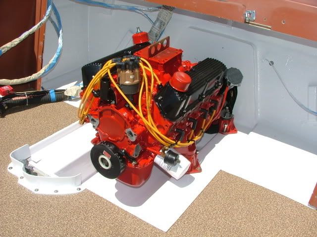

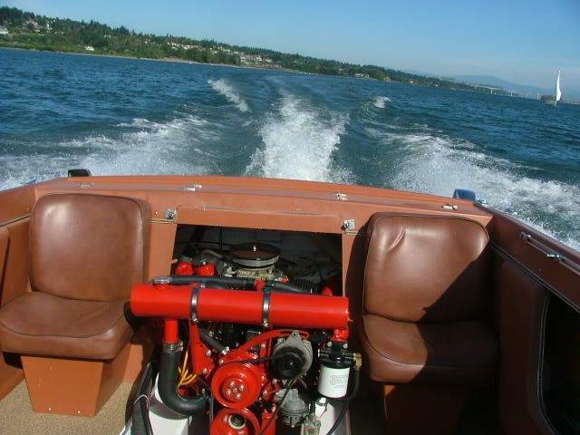

Jim, a great boat to put back on the water but IMHO, a 351w would be too heavy, too tall and too wide for your boat. I'd stick with the 302. Why push around an extra 75 lbs and rearrainge your back end, when their are great options for your 302/5.0?
After spending 4k building a 331 stroker for my 20 ftr, then having it stolen I was out of cash so I did the following. It proved to be such a huge improvement on my original 190 hp motor, I should have done it in the first place.
For $900.00 I got a Ford Explorer 5.0 liter salvage yard motor, with 35k miles on it.(just broken in) They have Fords latest, greatest, best breathing heads, the GT40P's. It has 9.0:1 compression, yours has 8.0:1. (still run regular) I stripped off the fuel injection, added a Edelbrock 2121 performer manifold, used a Holley 600 cfm 4bbl, had Delta Cams (oh did I mention, it is also a roller cam block:)) grind me a '69 351w cam and installed the appropiate size 50 0z balance flywheel and front balancer. (roller blocks are 50 oz external balance, not the 28 oz like your older 302)
This motor scares me to death when I open the throttle, I still have not run it flat out. I think the stolen stroker would have been way more than was practical.
The other nice thing about this motor is the Ford rotated the plugs down and straight out on the GT40P heads (better firing angle). This gives hot rodders a headache because it points them right into the headers. With the upturning marine water jacket mani's you can now use a a ratchet and socket to pull the plugs instead of a box end wrench.

Boomyal, that thing is beautiful!:eek:
The great thing about a FWC conversion is you don't have to pull the heads and put in SS head gaskets or worry about installing brass freeze plugs.
Of course, those will cry "It's not a marine engine! You can't do that! It defies the laws of physics and the earth is going to turn backward OMG!!!"

Re: Restoring 1974 revisited.
boomyal, looks sharp!! you need a clear plexiglass doghouse to keep everyones drool off of it... maybe something like a ferrari :)
All true Eric. I never pulled the heads on this unit because the FWC unit had been installed on it's predecessor. Needless, I did not have to worry about the the freeze plugs and head gaskets.
All I can say is that there are countless motors available, like this one, at very favorable prices. They are the last and best that Ford produced.
Thanks kalla, maybe I should just make a plexiglass insert in the dog house.;)
