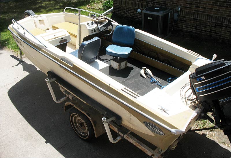

My father recently passed away and I inherited his '73 Glastron V-156 with a 65HP Mercury:
He was a very avid small-reservoir fisherman, and either he (and/or the previous owner) made some modifications to this boat that I'd like to undo, and return the boat to more of a factory setup.

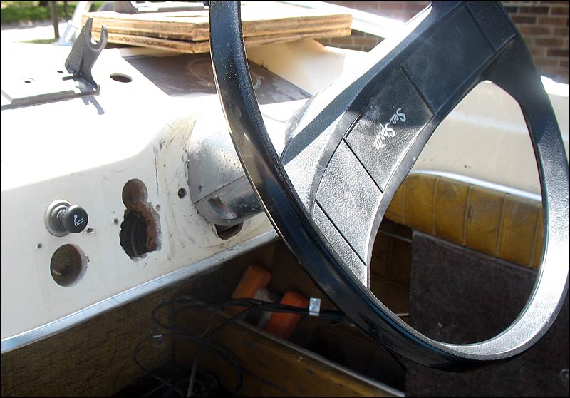

The steering wheel/column/hub is from a Sea Sprite, based on the script on the steering wheel:

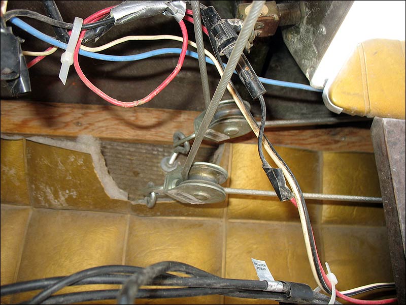

The steering cables come off the drum and into small pullies attached to the side:

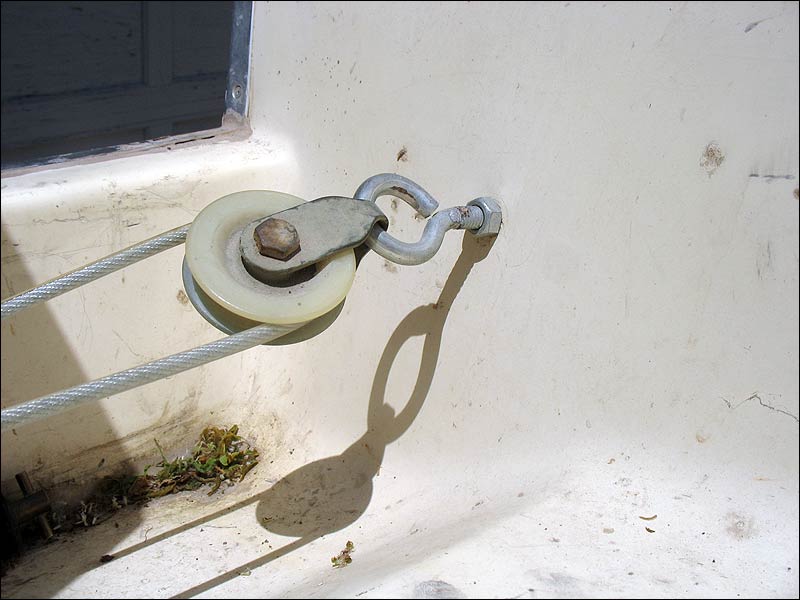

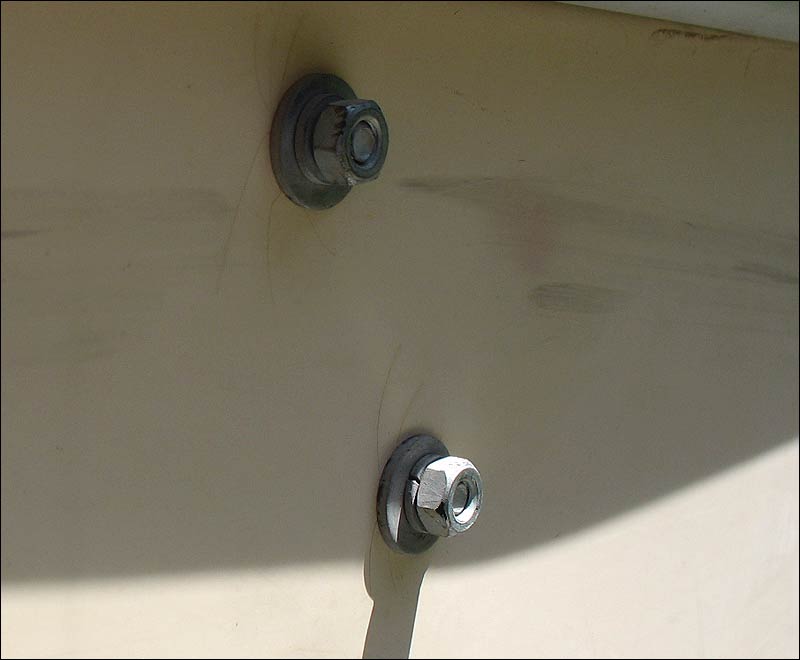

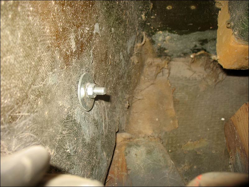

...and which were mounted by drilling all the way through the hull. (Note the small stress cracks.):

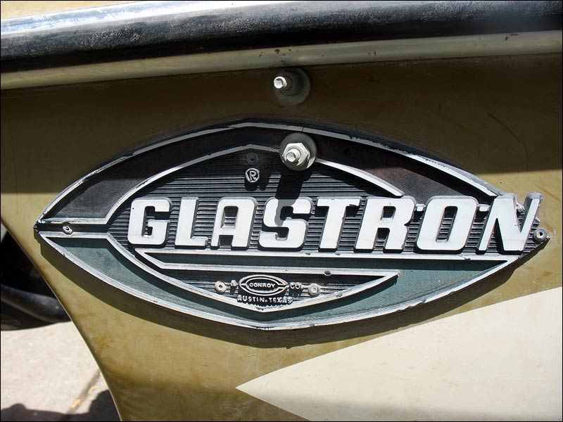

The cables continue to the stern, where another pair of pullies is mounted (right through the Glastron emblem!):...

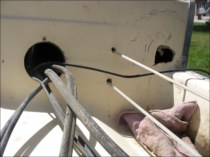

...through a pair of obviously-added holes...:

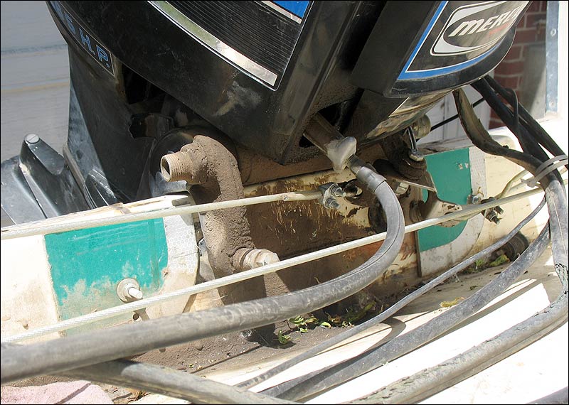

...and then one cable attaches to the engine...:
...while the other cable extends over to the port side, through another pulley.:
So...the question is: How was the factory steering set up, and how hard would it be to restore it back...assuming I could find the correct parts?
