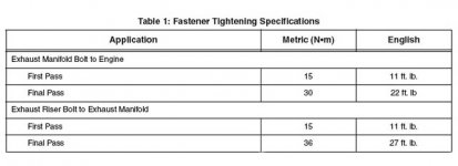

I'm going to attach the Volvo service bulletin for the exhaust system....
Out of curiosity, where did you find those torque specs? Sure doesn't say that in my Volvo service manual.
Lou C
Nov 10, 2002
14,519
I did it 4 years ago so I can't remember exactly where I got em but I think it was from the TSB that seems to have disappeared. Those are the specs I used, using the Barr gaskets and no leaks at all, salt water use. But the Volvo updated gaskets are different, so if I was using those, I'd follow what comes with the instructions, hopefully they do list torque specs and not just refer you back to the manual because those are updated, changed after the manuals came out.
