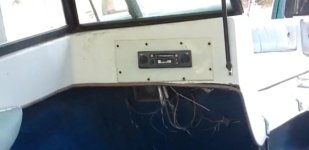

Just over a year ago some friends of mine bought a piece of property that the previous owners had abandoned all kinds of junk. One of those junks was this old boat. The previous owners had left the title (thankfully), and my friends gave it to me knowing my obsessive nature and love of projects. They were mostly happy to have one less eyesore.
I took it home, thinking it could use some upholstery and carpet. Silly, naive me. Soon I found myself going through the usual steps of ignorance, denial, grief, sweat, itching, cussing, and poverty. As I emptied and explored it, it just got more and more rotten. At first naive me thought it was reasonably ok. As I dug in, literally, it appeared as though the boat was constructed of fiberglass
,dried up brisket, and some space aged powdered wood material. Even as I found it was rotten through and through, I was in love and determined to see it through. Ive been lurking and reading for a year. I thought about bringing all of you along for the build process, but I didn't want to feel like I was doing stuff for the sake of updating everyone. So as I near getting ready to put her in the water for the first time in 10 years, I thought I would catch you up.
This site is amazing, and the participants are amazingly helpful, especially when they give out advice you don't want to hear, but should definitely listen to.20210605_122616.jpg

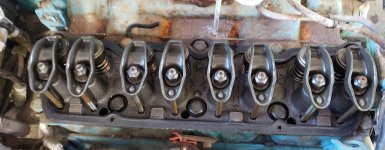

I spent the first week cleaning it out and getting it running. I couldn't believe how clean it was under the valve covers. I threw some parts at it, nothing that wouldn't have needed replacing anyway. Coil, cap, rotor, points, plugs etc. Once it fired up, it sounded healthy. 😁Fortunately the p.o. had drained the block before letting it sit.
Once I knew the motor was good I started deconstruction, measuring, photographing, and keeping as many important parts intact as possible.
