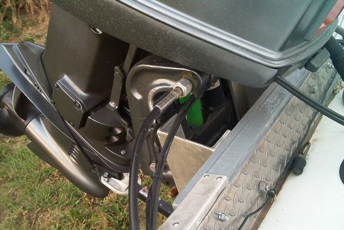

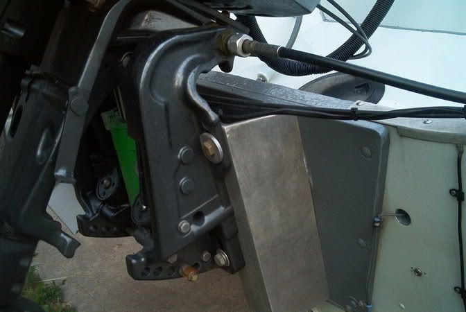

Yes, it would...But, we could add a set-back plate with holes and still use the 1 in 4 hole job, but get the engine back and up and gain a hand-full there.<br />I'm going to take a pic of my 200 hanging on the plate I made and post it for you to look at...be back soon...

Thanks Kenny, that looks like a pretty nice job! This would be similar to the "non-adjustable" jack plates that are available in the $100 price range, right? I could probably fabricate something like what you did here at the shop, but it might be quicker and easier for me to just pick one up. How much set-back does yours have? Did you have to go to a longer steering cable or other controls?

6" with the alum channel..<br />I installed a steering cable when new that was 1 ft longer than needed for this reason.<br />If the throttle and shift cables were of the proper length to allow a good size circle in the splashwell, you shouldn't need to change cables..

Kenny -- when are you putting the hydraulic cylinder in the plate?<br /><br />BTW -- that doesnt look like a Turbo II.....

Good to see ya back, DH... :) <br />I had just got back from a walleye tourney and that's a 15X17 OMC alum on there, actually cut down a bit....makes a good trolling prop.
