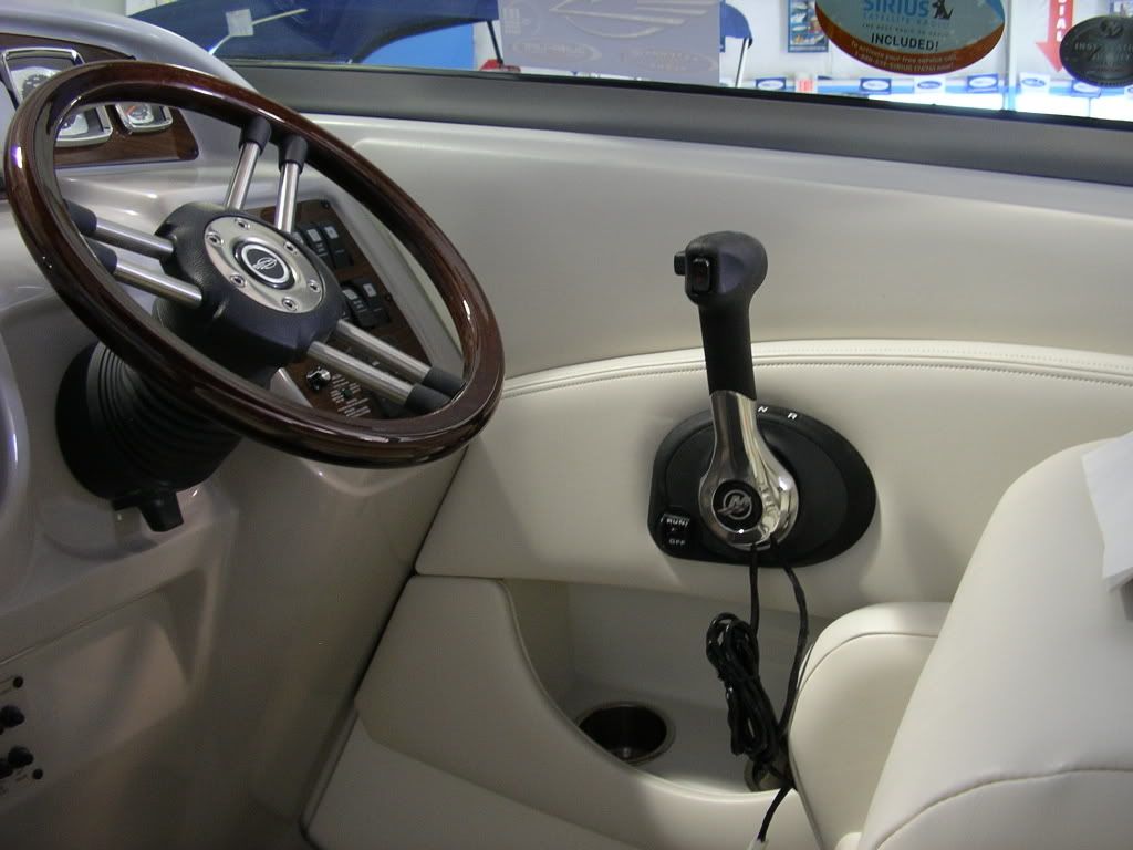

I'm assuming it is just the switch in the lower left of the throttle control in this picture?

I have the same switch. It is for the lanyard. I don't use the lanyard though. When we stop and the kids are on the boat I turn it off just in case they mess around. The engine will crank but not start.

That is the switch in your picture. I suppose the previous owner disconnected it for reasons stated herein. Thanks sincerely
