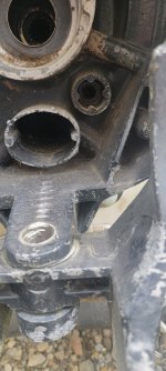

Just to clarify tho. The small hole off to the right is the water inlet right ?
No that hole is the shift cable. Looks like your gimbal ring and bellhosuing is off? There is a 5/8 hose that connects to bellhousing clamps on a right angle fitting at top above gimbal bearing can put a hose on there or go inside engine compartment and find hose coming up from drive to the heat exchanger. Can stab the garden hose in there.

Looks like we'll need an whole overview photo of what you're working with there.

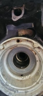

Ahh the rusted pipe right above the gimbal race here?
Also while I'm asking... again just trying to get reacquainted.... what is the hole at the top there that takes Two bolts?

ah good call. got new sending units and water pumps and all the good stuff. I'm ready to get this boat back to running. I appreciate everyone's quick responses and kindness this afternoon.
