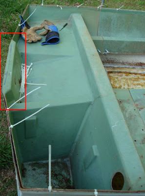

BTW, it goes here:

put some 30 grit on a belt sander and take off the area needed. will take about 5 minutes. looks like this area is all the needs to be taken off.
Nah, the thickness of the whole piece had to come down 1/4". I'm not sure how I screwed up measuring the original piece but I did big time. I've been taught better too.:redface:
