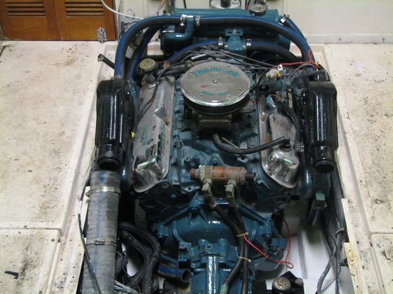

Okay guys, heres the skinny: risers off mani's, may need manis off block. bolts are ALL in recesed or tight holes, cant get chisel, grinder, or socket in there. only thing that fits is box end wrench, (on risers), on manis bolt heads are rusty enough to partialy crumble when wrenched, leaving me with nothing resembling a bolt head, but enough to hold heads on. Alen: engine in boat, not rebuild. tried mapp heat and pb combo, NO DICE. hav'nt tried beating them to chunks yet.

how long have you been working on this? if you dont wanna pull the motor pull the heads. post a photo I would like to see.

Woody take a step back and a deep breath.
Told ya on the phone it ain't gonna be easy with this one. Sat and sat so long near the ocean. Saltwater will destroy anything resembling metal.
Knew it was no walk in the park.
Risers off and one big ball of rust i bet and useless.
Same problem with the manifolds, they won't want to come off ether.
Everyone wants to help.
I'll bet the manifold are gonna be bad also, but you and i both know they got to come off.
Take your time,i know your getting anxious. Step 2 get em off.
Want to talk you got my number any time give me a ring. Or send me a pm and i'll call you i have unlimited land phone long distance don't cost me a dime.
Have unlimited cell to another Verizon cell user also.
As always good luck !

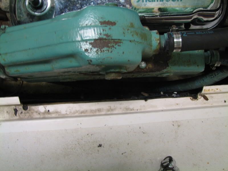

A dremel tool works great on hard to reach manifold bolts.

Here is what I had to deal with:
I was able to get in there with the dremel tool and cut the heads of the bolts off on the manifolds.
You can do it!
