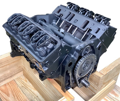

I found a place that does high performance and marine engines ~$2400 with core return, no intake manifold. Look to be a good deal includes shipping right now too. Tristarengines.com Any body have a critique? btw, already have new exhaust, starter, pressure / temp sensors etc.

I have seen their website but don't know anyone with experience with them.
Another thought is a local machine shop, if they can find a good core since there are no more new 4.3s (the old cast iron version we have) they might be able to build you one. If you can find a trustworthy place, might be easier to deal with a local machine shop/engine rebuilder than mail order.
