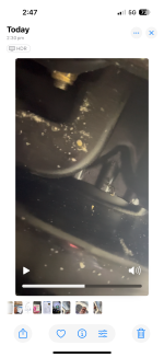

Hi, I’m new, I have a relatively slow saltwater leak as per photos/video in. Drip coming from the underneath of the engine side of the middle of the exhaust y pipe. Small volume of water pooled below prop shaft as per photo but very hard to see exact source. I know steering pin leaks common but that looks ok superficially. So that leaves exhaust pipe leak or leak from the prop shaft? I’m hoping the engine doesn’t need to be pulled out to be fixed. Any help much appreciated.

It could be the Y pipe but seeing it's on top of it I would lean more to the drive shaft boot. When was last time the boots were inspected/changed?

Was only serviced and inspected 2 months ago. The drip is coming from underneath the y pipe.

I see it coming from above it,
Does it only leak when motor is running?

Ok I’ve found the leak, small amount of water coming from top of y pipe exhaust where it goes through transom. Only when engines running. Checked the steering pin where it goes through transom and seems dry. No other leaks detected. Photos of when leaking and when dried off. So my next question is is this a seal issue? Presuming when engines on the turbulence causes it to leak. Also presuming to fix the boat has to come out of the water as submerged when boat in the pen. I’m thinking the recent stern drive service may have slightly disrupted the seal as it wasn’t leaking before hand. All your help much appreciated!IMG_5215.jpeg
