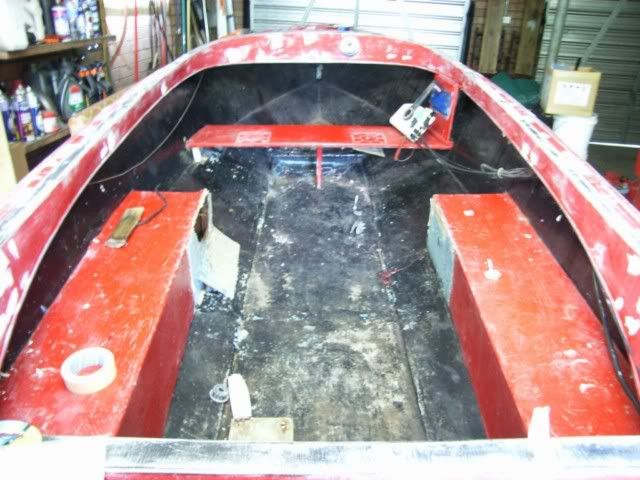

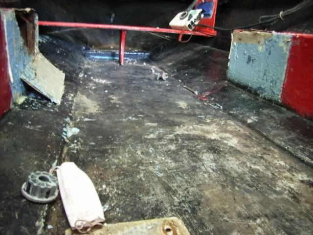

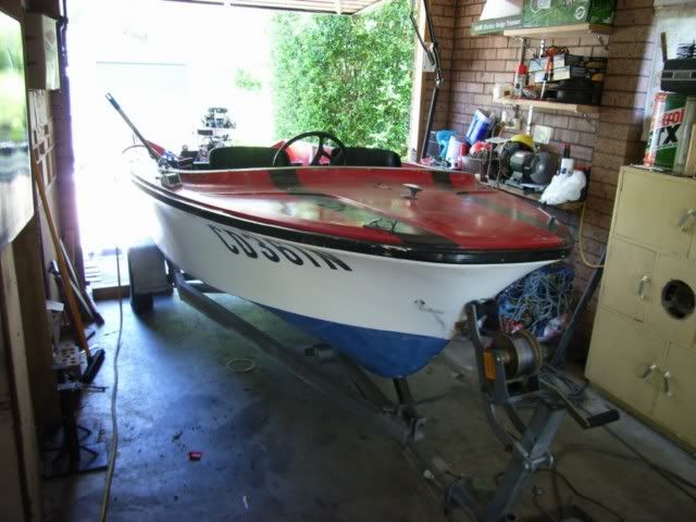

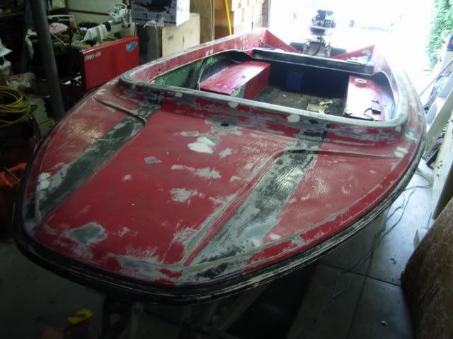

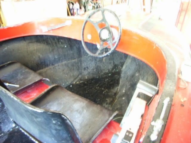

Oops, yeah i would like to fit pedistals of some sort but wasnt sure if there was going to be enough strength in the floor. I drained the lower bung and got 2 full buckets of water. Does this mean the stringers are had it?
Mark and Paul are right, i just went out and measured it and it is a 14 foot. Was advertised as a 16 foot. Didnt check it for length. Though i mainly bought it because it had upfront steering, johnson 30hp that needed minor repairs, and was cheap.
And yes that is the boat i have Paul!! Mine had the same windscreen too but it was all bent up and untidy. Was the first thing i removed, but would like to build or buy a new one. I doubt you would be able to buy a screen for these anymore?
I managed to get some pics up. Not very pretty....yet. Would like this boat to resemble the boat pictured at the top, but with some padded seats.
Thanks for your replys
