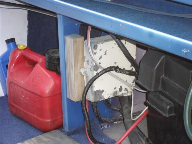

You should have a solenoid box like this with your main wires coming from a key switch and going out to your motor.
The switch should have an elec choke option. (push key in for elec choke to engage)
I don't have a box like that anywhere that I have seen.
