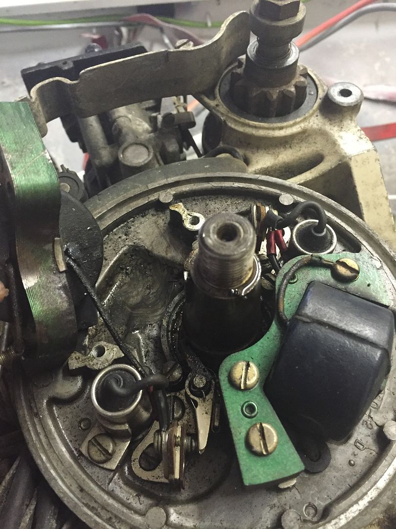

Today I got the flywheel off of both my engine and the donor/example engine. As a refresher, my problem is that I only have one wire coming down from the magneto. Once I got the flywheel I off I see that there isn't even a hole drilled in the plate by the coil for a wire to go through. Were these holes factory drilled or did someone add them? If they are factory, why would I only have one wire coming from the magneto? Here are pics, the crappy looking engine is the donor engine and the cleanish one is the one I'm working on

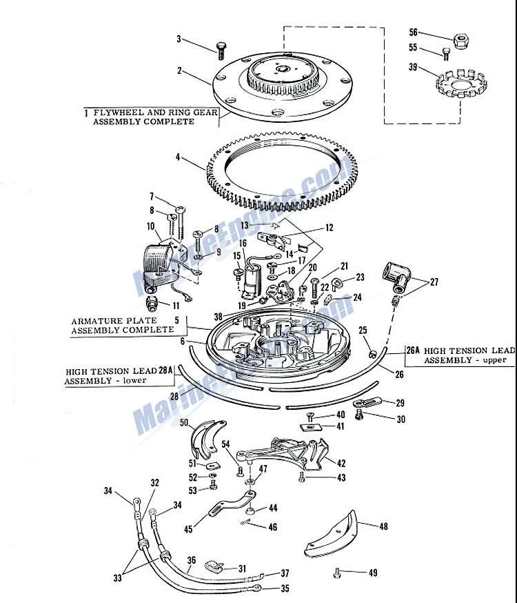

Getting a bit more confused. Looked up the magneto group on the diagrams and It's only showing one coil??? Anyone have any input?

Another question would be, without a stop button or kill switch, how did someone turn this engine off? The way I understand it, you have to have a wire to each coil in order to kill the engine. Is it possible to run a wire from one coil to the other wire that goes through the plate and to the vacuum cut out switch and have the same effect with a switch?
39,222
????-------The picture shows one coil , that was done to avoid clutter in the picture.----------It uses one coil for each cylinder !!!!--------Pulling the choke on is a very acceptable way to stop one of these motors.
