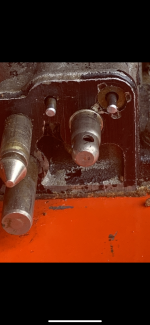

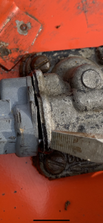

John Drew98
Seaman
Feb 13, 2020
72
I know the gas fitting you refer. How do you get the fitting apart? Where do you find the o-rings? For some reason the right side does not " seat" up next to the housing .
