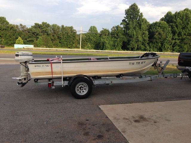

I have 1978 16ft Starcraft Kingfisher. Ive had it for about 7 years now. When i first got it the original floor was still in it and very waterlogged. I also took out the side console and converted it to tiller steer, which i love because its just a fishing boat. In the picture the boat has a mean mud line on it from cat fishing the James every week. I am thinking about painting the inside and outside of the boat and extending the front casting deck.
