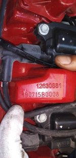

HI
There is a serial number engraved on the bloc :126 30 881 and 19 07 15 b0008 (see attached picture )
Do you think it can be a useful information ?
THANKS for your help

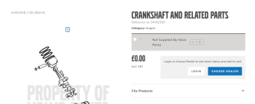

HI
Unfortunatally on the volvoshop, the segments are not supplied (see attached )and no delivery time is indicated. Even the local dealer , has no answer , that is why I am searching other equivalent on a similar VOLVO PENTA engine .
are you needing crank shaft parts and related?
Ayuh,..... If yer lookin' for internal parts, as Scott says, they are GM / Chevy parts,....
Not Volvo,.....
