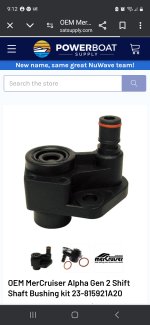

The only bushing I replaced is at the top of the shift shaft. Like in the below picture.
