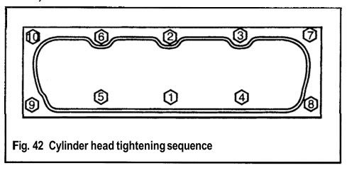

My be thats it. Can you tell me what the proper sequence is. WILL SEE IF MY MECHANIC KNOWS WHAT HE IS DOING !!! I KNOW HE IS TORQUING AT 100 LBS.

Here is the sequence, make sure the bolts are not torque to yield, as I mentioned before, a stretched head bolt will pop a gasket every time.. look at the threads as shown in the diagram.
Also, if your mechanic is old school, make sure he is not coating the composite gaskets with anything.. only steel gaskets get coated... and of course, don't tighten each bolt to final torque all at once, go slowly in this sequence until your final 90-100 lbs is reached
