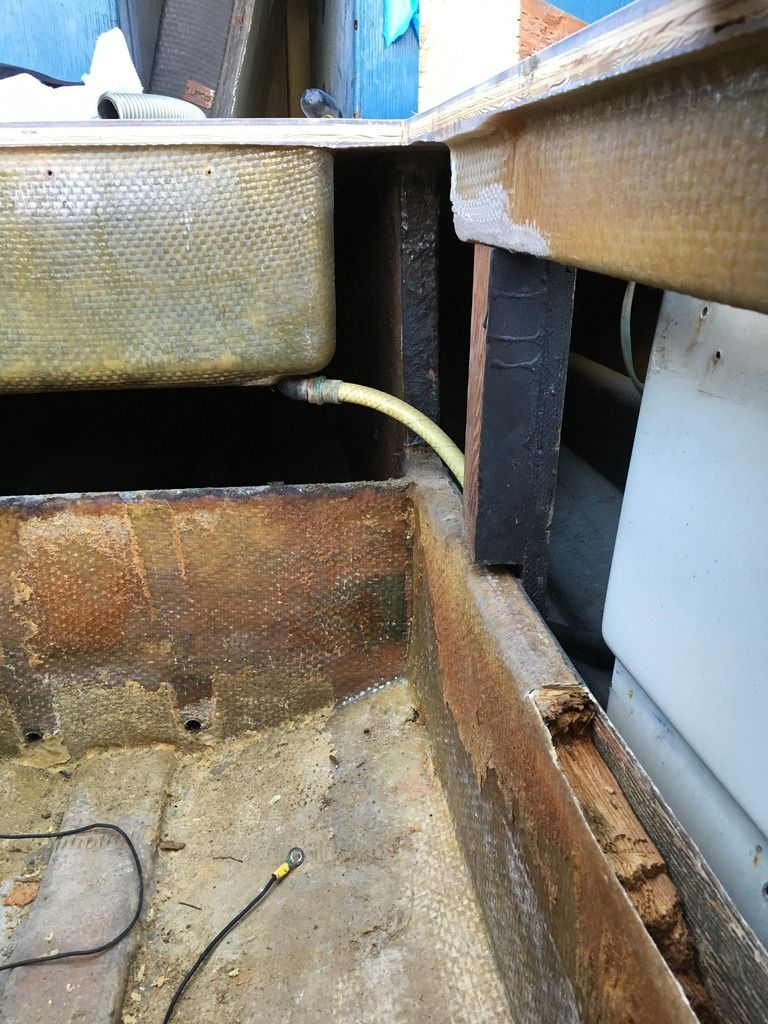

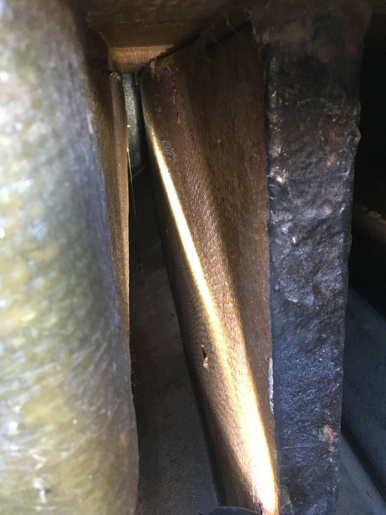

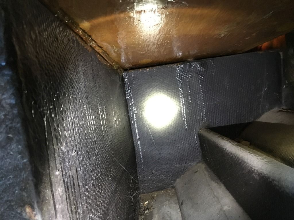

Ok here are a few pics of what I have going on. Not the best photographer so bear with me.
Starboard stringer looking forward. Cut part of the top off near what I thought was the epicenter, hoping I could dig it out and use seacast or similar product. I don't know how far forward the rot goes but it's at least delaminated as far as I can reach my arm. I'll have to cut out more of the deck to assess the damage better.
Looking under the deck along the right side of stringer. Looks like the deck is just sitting on top of the stringer and bulkhead with a shim in between.
Looking under the deck along the left side of stringer. The bulkhead in the background is inside the cabin. Again I'd like to replace just the rotten section because I'd like to go the least invasive route.
