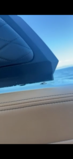

Hello everyone,
I am posting here because I would really appreciate the opinion of experienced Chaparral owners, marine technicians, and anyone who may have seen a similar failure.
I own a 2025 Chaparral 267 SSX, purchased new. Unfortunately, the boat has had a number of warranty-related problems since delivery, but the most serious incident happened recently while I was on the water with my wife and children.
The hard-top structure suddenly failed and became unstable while underway. The movement was severe enough that I no longer considered the boat safe to operate normally, and I had to secure the structure temporarily before returning.
This incident is especially concerning because it was not the first warning sign.
Previously, I had already reported:
  • Hard-top mounting screws becoming loose and coming out.
  • Continuous cracking/creaking noises from the hard-top structure.
  • Additional loose or unidentified screws found inside the boat.
  • Repeated concerns regarding the hard-top mounting points and structural connections.
  • I had specifically requested a complete inspection of the hard-top and its connections before this latest failure occurred.

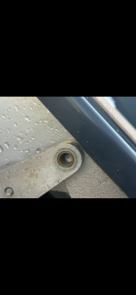

After the incident, I opened the upholstered section around the hard-top mechanism so I could document what had actually happened.
What I found was very serious.

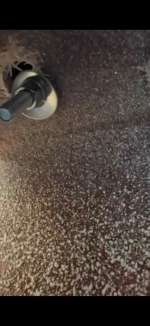

Both lower hard-top actuators appear to have suffered structural failure.
The aluminium components that support/hold the actuator cylinders are broken.
On the right side, the actuator rod itself also appears to have pulled out or unscrewed. A threaded section is clearly visible, which makes me suspect that it may have progressively loosened until only a small part of the thread remained engaged and then finally pulled out under load.
In addition, the main bolts connecting the actuators to the hard-top structure were loose, and at least one of them appears to be broken.
I cannot yet properly inspect the upper actuator connections without further disassembly, so I do not want to speculate about their condition.
At this stage, I have deliberately not allowed the hard-top to be repaired or dismantled further, because I want the failure to be professionally documented first.
The boat is currently effectively unusable.
I am now trying to understand whether this type of failure has ever been seen on another Chaparral hard-top system.
I would especially appreciate opinions on the following:
  1. Has anyone experienced loose hard-top mounting bolts or actuator failures on a Chaparral?
  2. Is there normally a locking system, thread locker, locking nut, pin, or other secondary retention method preventing these actuator connections from progressively unscrewing?
  3. Could failure of one mounting point overload the opposite actuator and cause a cascading failure?
  4. Would you consider broken actuator mounts and loose/broken structural bolts on a nearly new boat to be an isolated component failure, or would you recommend inspection of the complete hard-top structure and all mounting points?
  5. Are there any known service bulletins, recalls, or previous cases involving this type of Chaparral hard-top mechanism?
I have extensive photographs and videos documenting the condition before and after the incident, including the loose screws, previous hard-top issues, and the current broken actuator components.
I am not posting this simply to criticize the manufacturer or dealer. My main concern is understanding how this happened, whether the installation/design is correct, and whether the boat can be considered safe without a complete structural inspection.
Any technical input or experience with the Chaparral 267 SSX hard-top system would be greatly appreciated.
