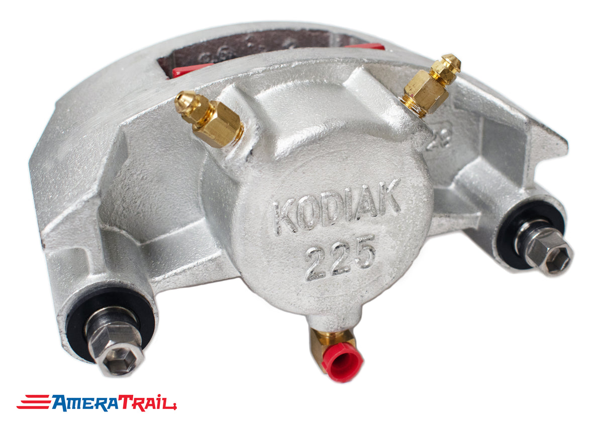

I was in the same situation with my Kodiak Calipers three years ago.
If you count the cost of the rebuild kits along with your labor, it's not so silly
I have way more time than money- if your swapping vs rebuilding, I'd say if everything comes apart its an extra 30 minutes of parts and cleaning up...

Stainless steel can rust and is notorious for seizing and gulling in assemblies. If, or should I say when you get the piston out, there is a very good chance the bore is toast and you end up buying a new caliper anyhow.
Rebuild kits where $65 - $70 each when I changed my calipers. A new caliper was $30 more....made my decision pretty easy.
The best price I found on line , which included pads, 150 bucks. The kits are still 80 bucks so x 4...

So...talked to my buddy chat...chat gbt and I would have never thought of it..local hardware store for a Greek zerk, installed where the inlet to the brake line is...i left all the liquid I sprayed in there...starting pumping...couple of pumps more...some pops and walah!

Sorry if it was not clear. Just like you might use an air compressor to push the piston out (which did not work), I put a grease zerk fitting where the break line connected to the caliper and used my hand pump grease gun and it pumped right out. The grease gun has a back flow valve in it and develops way more pressure than air can. I can imagine other times when something is stuck this would work. My lesson in physics for the day.

Is this a technique for pushing out a brake caliper piston?
if so, I’m wondering about the grease remaining in the cylinder 🤔

Wonder if a Mightyvac would do the same job. I know they can be used to bleed brakes, but I use a Lisle one man brake bleeder, it's a simple device that works well.

I would think contaminating the brake fluid system with grease is not a good idea

What i could have done is use the trailer mater cylinder to puch it out- but I had already replaced with a new and wanted to rebuild so I always have a spare.
