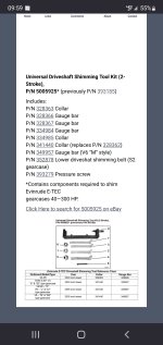

I believe these are what's needed correct?
Part# 393185 omc shimming tool
Part# 339184 omc shimming collar
Part# 339185 omc shimming bar.
I put pictures of them up just in case...not to scale
But I believe tools correct...
Please let me know if I have it right.
Thank you all again.
Sean
Edited for clarity
2nd picture is of universal kit that was recommended by initial Part number.
I can put together the 3 tools for the 40-50hp gearcase for about $140 by themselves.
