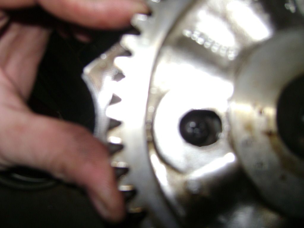

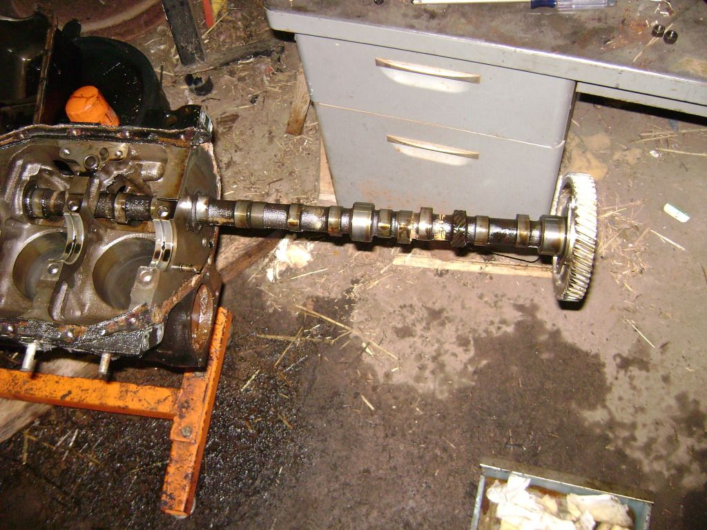

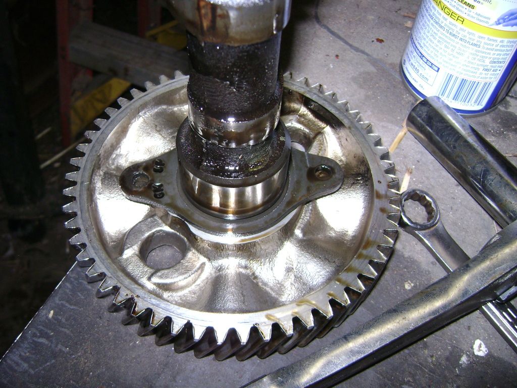

Well, I didn't do much on her today but I did take the cam out of the motor and the rest of the lifters. (4 were pretty stuck and I had trouble getting at them from the top.)
These straight sixes are a little different from a v8. On my 350's, i can just grab the cam and pull it out once the chain is out of the way. The cam on this 250 has a thrust plate under the timing gear. There are two access holes that you must align with two screws inside to loosen this plate. Once they are out, the cam pulls right out.
Everything looked pretty good in there. I didn't see any copper on the cam and the cam bearings look pretty good. Either way, they will be replaced though. I hope to drop the block off at a shop this weekend to get the work started.
I guess the manifold was the cause of this rust? I better get one of those on order as well!

The manifold COULD be the issue, is it crazy rusted inside? can you chip off huge chunks with a screwdriver?
If it is suspect at all, and with a new rebuild you really dont want to risk your motor due to a 200.00 manifold. Get a new one.
It could also be that part of a shutter you posted earlier I commented on allowed water to be sucked into the motor, it waterlocked p and sat, rusting away waiting for you to save her..

I have a good feeling about the block on this one. The motor didn't see too much use, as the bores are still factory sizes. I thing a .020 or .030 bore at the worst should clean it right up. If it wants to be really stubborn, I will have #5 sleeved but I doubt that will be the case. I looked it over pretty hard and don't see any signs of cracks. The cooling passages have some rust though. The rear most passages into the head are the worst. I can chip pieces off with a screwdriver here. I will have it cleaned up and hot tanked to get rid of that stuff hopefully.
A new manifold will be purchased for this engine. One thing I am kicking around is to change it to a closed cooling system. This boat will see brackish and salt water occasionally. I will run it on muffs when I pull it out of the water and then spend an afternoon or so on the river to make sure it is flushed out. I just don't want this thing to rust like it is now. I haven't shopped around for the kit yet, but most of what I saw was around $700. It kind of made me wonder if I could piece one together for cheaper, but then I would be up a creek with the manifold issue.
The manifold is pretty rusty, but not flaking rust. I'm at a loss with it but I don't want to take that gamble either.

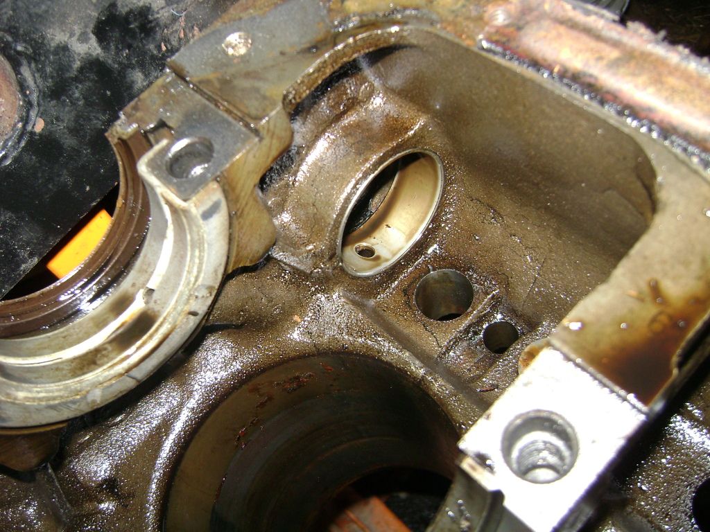

Oh man, I have a problem.
This morning I through the block in the back of the truck to drop off at the machine shop after work. As soon as I got the block in the truck and in the sun, I saw it. A crack half way down the #5 cylinder. :facepalm:
I don't know if it's the whole way through, but I can see a .060 bore will not clean it out.
Plan B?
Reman long block with a 7 year warranty. I found a few sites that had them for $1,259.00
I guess I will stop by the machine shop and see what they have to say, but I think this will be cheaper than fixing the block at this point in time.

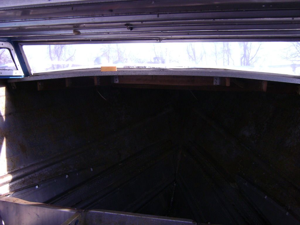

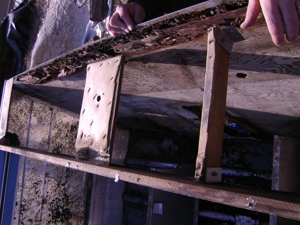

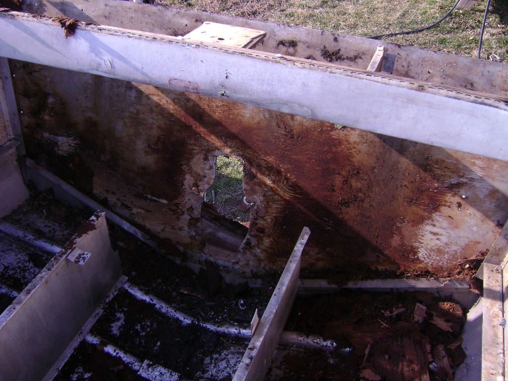

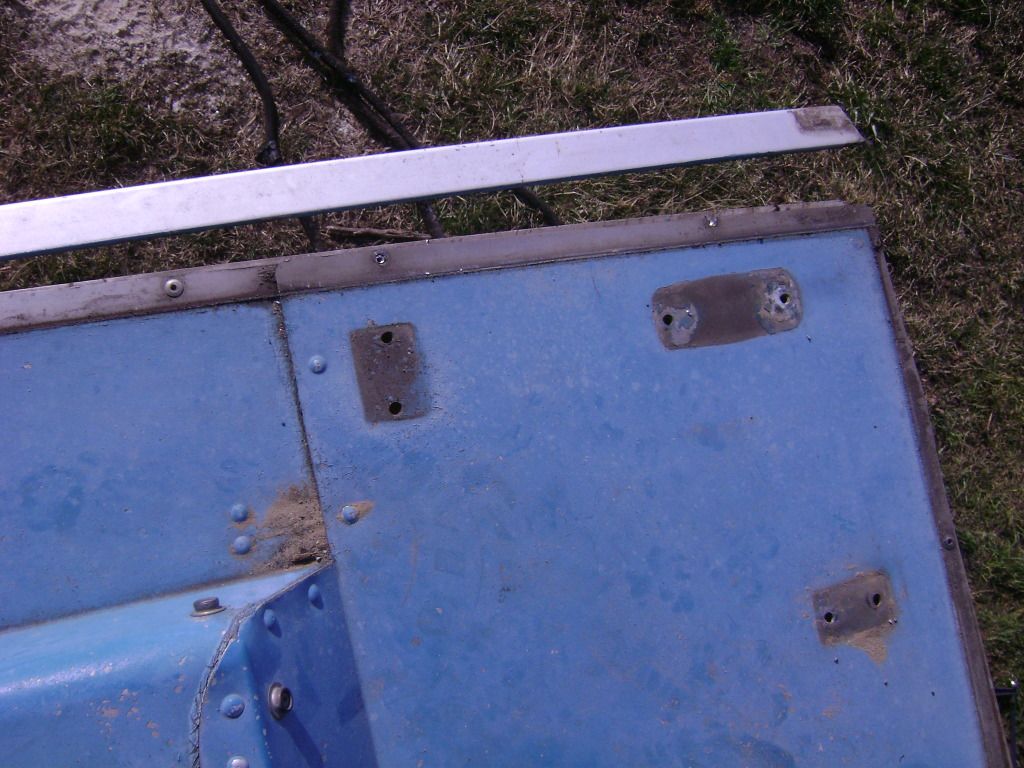

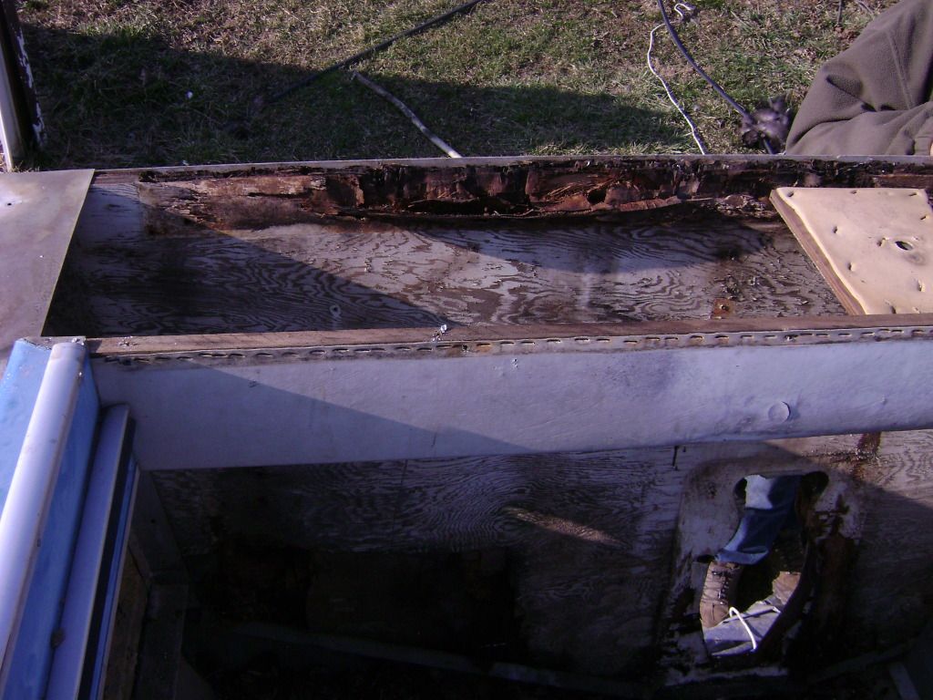

I made some progress today. I ordered a rivet gun, bucking bar and some rivets. Then I went out and stated on the boat. I took out the rotted part under the windshield and then took out the transom! It was a total loss. I pulled it out in 2 big hunks, and 5 gallons of pieces. I took some pictures, but I don't have the camera with me at the moment.
To get the transom out, I took off the railing around the back of the boat. I took out the screws that went through the transom from the outside of the boat. I then took the corners off the rub rail and took the back rub rail out. I then took the screws out of the metal rub rail housing and pulled it off the boat. Then I took the rub rail off the sides. I had to pull the front cap from the boat and drill out the rivets that held the rub rail in place. Then I could slide the sides out.
I loosened the rub rail housing at the transom where it was holding the metal in place preventing the transom from coming out. Then I drilled out the rivets that hold the piece of metal over the transom and took it off the boat. The tabs from the gunwhale that were over the transom bent out of the way easily. I will have to problems putting the new one in!
Now my next step is fixing rivets, and fixing that cracked rib in the front of the boat. I am going to start cutting out panels for the boat, but im not going to install them until i have the gluvit finished.

Here are the pictures of the job. Tomorrow I am going to fab up the new board to support the bow and the board in front of the transom. I plan to install it the following day. My trip to Japan is postponed to next Wednesday so I still have time.
Oh yeah, and my bucking bar arrived today! I can't wait to start painting this beast!
