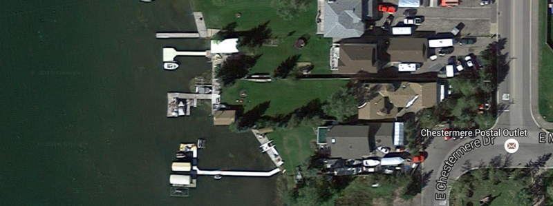

Right now, she's sitting on a lift on the middle dock:
