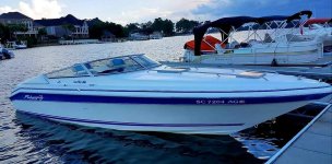

Are you using OEM merc impellers or aftermarket ? I know the gen one impellers don’t last as long but I was getting at least 5-6 years on mine back in the day.
If you have a pic of you boat post it I’m on my second sea Ray and always liked the Pachengas
pachanga58
Sep 19, 2021
18
Hopefully it is ok to insert three photos here as you asked. it's an 1989 Pachanga 27. Very original. Power is twin carbed 5.7Ls with Alpha outdrives. Have to overlook that my trim gauges do not work. I have so many hours in this boat I know where the tabs and trim is at without looking at the gauges. same with how the motors are running in sync, they have an unique sound when both are working together. The Pachanga is a heavy boat overall but the twin 350 mags can push it to roughly 53MPH at WOT. I typically just run at 4000 RPM if the lake is clear of traffic. this is not a GPS speedometer but the old style pitot. Lake Murray in SC has gotten very crowded in the last couple of years so I have to watch for slower traffic, especially pontoons. Overall- very stable and can carve its way though rough water.
