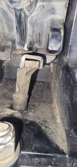

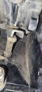

Believe i found out why. First pick is how it is supposed to be. This morning when I went out to check things out, this was the only thing I seen out of place. What would cause this to slip out? It feels like it should be springy cause I was able to put it back in place, and also was able to with 1 finger pull it out of place as well.
There's a washer/spacer in between the cases that likes to escape when they're split. Proper fix is to split the case and replace the washer, the "other" way is to put a hose clamp around the shaft to keep it from dropping back down. That's assuming nothing weird is going on. The drive should still shift by hand. However, if this is a new to you boat, you should 100% replace the impeller before you start using it.
Ayuh,...... As noted above, there's supposed to be a stainless washer that sits on top of the shift spool, that holds the shift foot up into the shift shoe,.....
