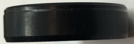

@achris I have a question to be 100% sure,
I have installed my shift shaft bushing and seal facing UP (spring facing UP) towards U joint bellows, is that correct?
so the exhaust side will be like this:
And do You think I can use some socket to push/hammer the upper drive shaft seal?
its 1 double lip seal
Franco_boater
Nov 2, 2021
146
@achris my friend, last question to You...
seal is with dual lip, but which side UP? Each side is slightly different\

Hello Chris again, in manual 6 it says lip facing down, in manual for alpha 1 gen 2 it only drawing like this:…
So what’s the correct? I installed both with spring up like this 1652942765486.jpeg
