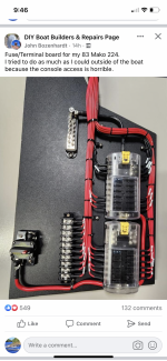

Planning my wiring build. I think I will make a panel on the bench and pre wire it with harnesses, then install it. Like this clean looking example.
Anyone know where I can get the labels?
Thanks
Watermann
Jan 12, 2013
13,822
Thanks
Yeah, do a search for heat shrink labels new wire marine has them.

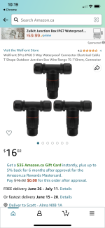

Anyone have any luck with these style T connectors?
I know I can rig up a y connection but I don’t like the heat shrink method. It allows moisture in.
