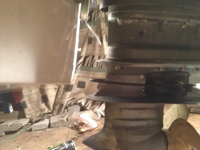

I've been reading a bit about proper motor height and I think my '67 Johnson is setup way too low. Currently, the cavitation plate is 2.25" BELOW the hull.
I contacted the PO to ask him if there was a reason the motor was set so low. He told me that didn't set it to that height, but had asked a marine mechanic about it a few years ago and was told to "leave it alone"....which sounds to me like the mechanic wasn't interested in dealing with changing the height.
Sorry for the crappy pic, but it'll give you an idea of what my setup looks like
I'm guessing that the current setup is probably too low and creating quite a bit of drag.

I think that reasoning is crap. The exhaust from your motor is discharged under the antiventilation plate. The A-V plate should run on the surface of the water. I recommend a water test. Run near full throttle and look at the A-V plate. If it is underwater, then the motor is too low. Whether you gain performance by raising it is another question.
Also, the water pickup is right in front of the exhaust discharge. Make sure the water pickup is under water, so no raising the A-V plate out of the water, right?

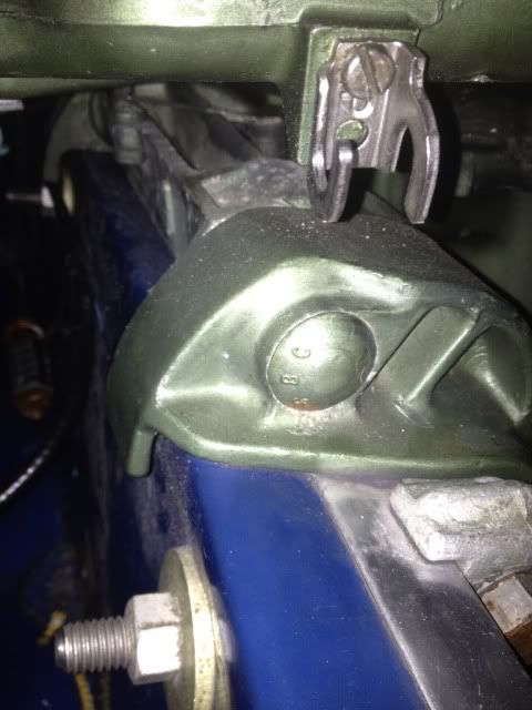

This is what my transom bracket looks like.
If I end up having to raise the motor....can I just put a piece of wood on top of the transom to fill in the gap?

Sure, you can put a 1X2 or something under the motor to raise it up a bit. Don't raise it above where the clamps or bolts can be safely used to secure the motor.

I wouldn't raise it unless you don't have to drill new holes. The least amount of holes in a transom the better.

I def wouldn't have to drill new holes. The bracket has 4 more bolt holes for the top bolt....and has a long channel for the bottom bolt.

you don't have to fill the gap. Lots of motors, if bolted on, sit off the transom top, despite the shape of the "hook over" part. If it makes you feel better, cut a piece of lumber and put it in there, and replace it if it ages. I wouldn't do anything permanent.

Old OMC motors were designed to run the plate below the surface. That is a left-over from the wood-boat days engineering. However, 2 1/2" probably is a tad lower than necessary.
Now, c'mon guys, that motor has adjustable stern brackets. All you have to do is remove the upper ones and loosen the lower ones, raise it up to the next set of holes and re-bolt it. The idea is to raise it as much as possible without getting prop ventilation or cooling water problems. If you do experience those, drop it back down a set of holes. You DO NOT have to shim the top. It may look funky, but that's ok. Those hooks on the brackets are for temporary hanging the motor on a display stand or storage rack.
Once you have test run it and are satisfied, remove and seal the bolts, one at a time.

On where your engine sits on the transom, I have a 300+ lb outboard that doesn't sit on the transom at all. It is held in place with the 4 bolts. Boat was built in '01 and I have had it since Dec, '04, and I play hard with it. No problems with engine mounting.

The cav plate is definitely too low. I took a look at the cav plate while we were WOT and it's def plowing water. It's not causing a huge amount of spray or anything, but def plowing thru the water.
Gonna raise the motor 2 holes and see what happens. I'll keep an eye on the tell-tale during WOT to make sure the motor's getting plenty of water.
