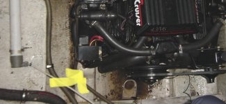

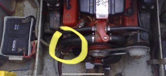

They both had the filter on the engine actually. The mercruiser was 1990. The VP an 89. The VP also had a pre filter on the bulkhead.

How sure are you that the Merc is 1990? Because everything I see on that engine says 1992, and they had the metal can filter, which had to be changed to the engine mounted spin-on (as the metal can was NLA and superseded to the spin-on kit)...
Pretty certain of it Chris. Although I bought the boat used…the boat was on the Loch here since brand new when she was imported and supplied to the original owner through Windermere aquatics (along with another 2 identical that year). Neither of these engines had an electric fuel pump I’m sure. The Vp I can say for certain didn’t. Only filter I remember being different from the rest of the GM engines I’ve had, was the oil filter.
