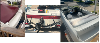

Got into trolling this summer pretty heavy on Lake Erie. I have a 2002 starcraft 1810 bowrider with a 4.3L merc in it. I was using the big motor just barley in gear, then my front mounted trolling motor on autopilot (on 3 setting) to combat the hull wobble to keep it locked in a straight line almost like a bowthruster. this worked GREAT
My question is regarding the longevity and viable nature of constantly trolling with the big motor and if a kicker motor is really required. My hull shape does not really make it easy to install a kicker, and all in it would be around a $2000 endeavour if i found a cheap one. Should i keep using the big motor? Risks? Is this terrible for the motor? I assume its not "great"
attached is my hull shape for reference. i feel like its gonna be a pain in the butt to have a kicker or even use it but i also dont wanna kill my engine

This is the current setup. it just occured to me that i did not mention - i do have a trolling motor. 2025 terrova 80lb 60"
